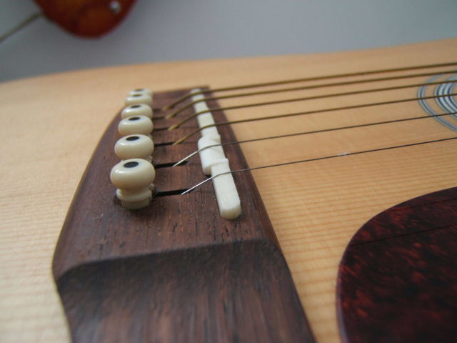

What Tony said about the "G" string is common place. I often find the "G" playng too flat and needing to be moved toward the nut. That's realy what you want to keep in mind when considering where to slot for your saddle - how much travel room do I need, and in what direction(s). I use Stewmac's intonation saddle jig to mark off approximate location of the saddle and then give myself room to tweak it sharp or flat as needed. Remember too, if you need to, you can always add a "shelf" on to the saddle for any one string to get the intonation right-on.

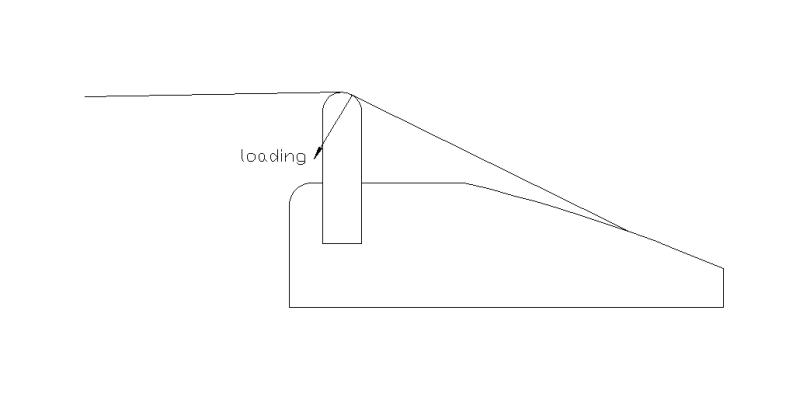

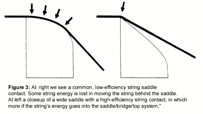

   Michael, I see your point about the single break point. Maybe I was explaining myself incorrectly. I decided ot use the larger saddle because of an excellent article I had read on Ervin Somogyi's web site... Here's the diagram that explains...
As he goes on to say, he doesn't have definitive scientific explanations/proofs why the wider saddle works better but he finds that in his experience, it just does.
From that diagram, I figured the string break happens nearer the nut than, say, mid-saddle. So that's why I asked my original question of moving the bridge (i.e. the saddle) a touch back to have the break point nearer the soundhole.

DaveSKG
From your photo of the Stew-Mac intonation tool, that the final optimum positioning of the saddle looks like a split saddle configuration. From the e to the g as one run, whick will get the G closer and then the second set at a slighter angle to the E. Is this a way to address this? What or how do you guys feel about this approach?
I am ordering one of those tommorrow

OK. Now a question. Do you really have the point that the string leaves the saddle shear as in your sketch? If so are you relying solely on the saddle angle to compensate for intonation? Please don't take this as a wise crack but this looks more like a nut configuration than a saddle. I guess because I intonate each string I can’t see how I would ever end up with a shear face at the contact point.
I agree having more string in contact with the saddle on the pin side would put more energy into the bridge therefore the Bridge plate and top. I just have doubt that with out intonating the nut you can get the intonation at the saddle in a single plane. Tony’s calc show it is not a straight line from E-e. not disputing, just thinking out loud.

[QUOTE=MSpencer] DaveSKG
White Oak, Texas[/QUOTE]
Mike,
Split saddle is one way. I usually use a wider/thicker saddle and cut each of my points into it. Then I don't have to build any "Shelves" onto it.For instance, in the pic above( not the finished one...the one with the jig ) I used a .175" saddle (thinned some) and it hit all the points I needed. Same reason Doolin and Somogyi uses wider saddles ( although I believe Ervin likes the sound better).Dave-SKG38786.3954976852

   Michael, a light just went on in my head. You are most definitely right. The intonation is not a straight line... That's why I didn't like the explenation given in the Cumpiano/Nathelson book. The way they say it, you just need the 1/8 pitch and you're golden...
   I took that little sketch from Mr. Somogyi's site. I'm sure it's exagerated because such a sharp break point would certainly break strings...
   I just want to be able to use the wider area of string contact while maintaining enough space to be able to intonate correctly. I'm feeling more confident now since the saddle I'll be using is very wide. I hope to be able to accomplish both. Thanks for your help and wish me luck!
